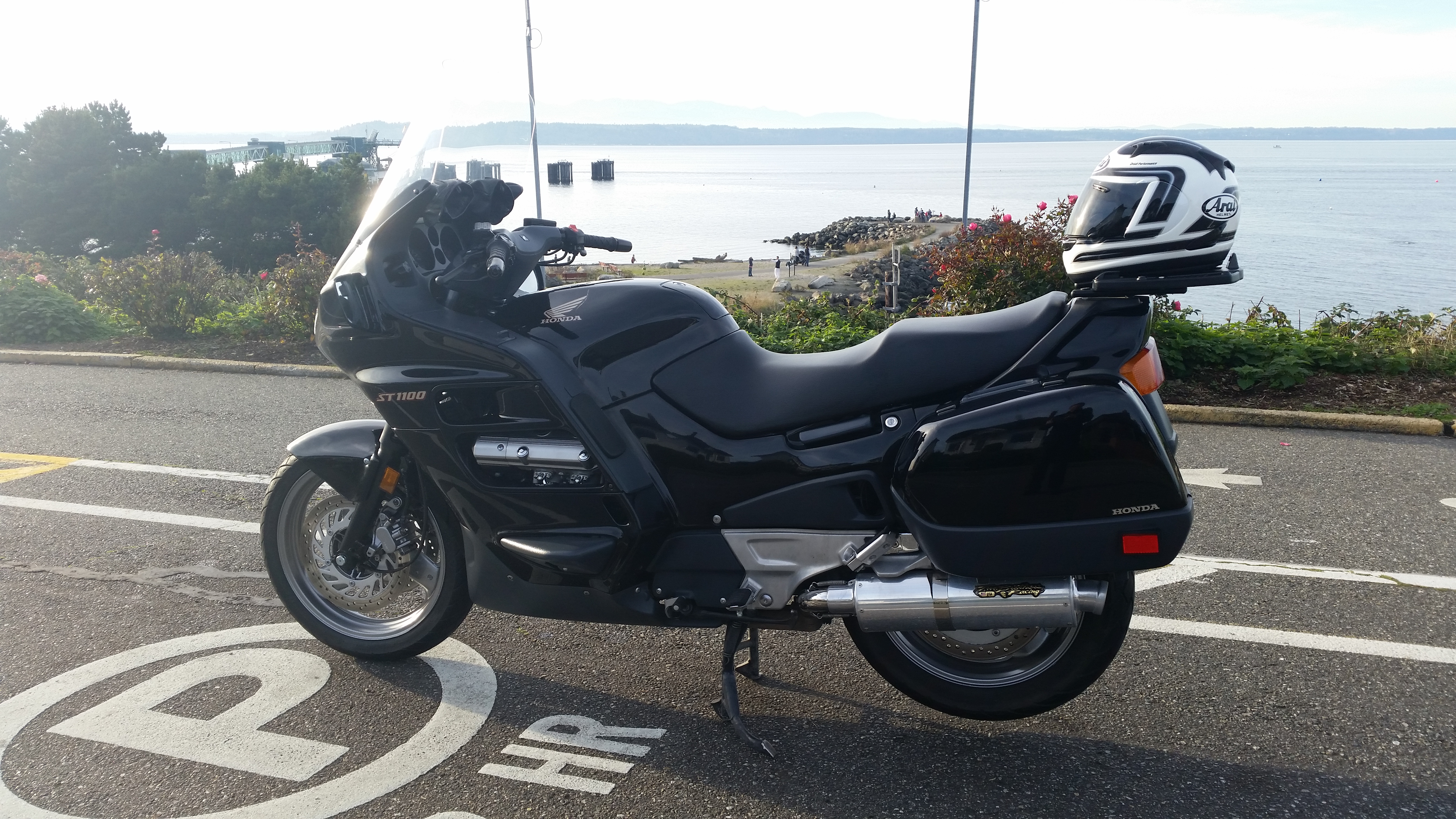

    For reference, my 1990 ST1100 came with an odd mix of TRAC/damper rod in the left leg and a non-adjustable cartidge in the right. I bought a spare right cartridge/cap and installed that in the left leg, but had to leave the bottoming cone (oil-lock piece in Honda-speak) out as it would not fit. Everything bolted up nicely and worked just as expected with no bottoming issues (still had the bottoming cone in the right leg). I also refurbed the cartridges with Gold Valves for good measure.

    Interesting. Bought a 98 ST1100 last year, 27K miles. Love the bike.

    I sold my 1100 this year along with my 99 VFR, and bought the ST1300. I miss both but needed to rationalise things a bit. The 1300 is quite a different beast to the 1100, quite a bit quicker, faster steering and sharper to ride, but misses out on the more gentlemanly aspects of the 1100 which was softer and frendlier (and cooler to ride). In addition to the forks I also put a Progressive 465 shock on it, and swapped the master cylinder for a smaller diameter one off my VFR which was a good improvement on the stock master which I thought felt too wooden with less grab than I wanted.

    I know the 1300s are good bikes, but I always wanted an 1100 after assembling the first one to arrive and taking a couple out of the shop on small trips years ago. Plus the 13 just doesn't fit my body anyway and I didn't want linked brakes. Sure takes up more room than my VFR's tho, she's big. I have gone back to stock exhaust because this is the bike for when the wife doesn't want to ride her own but we want to be on a bike. Now it is a silent rocket ship.
