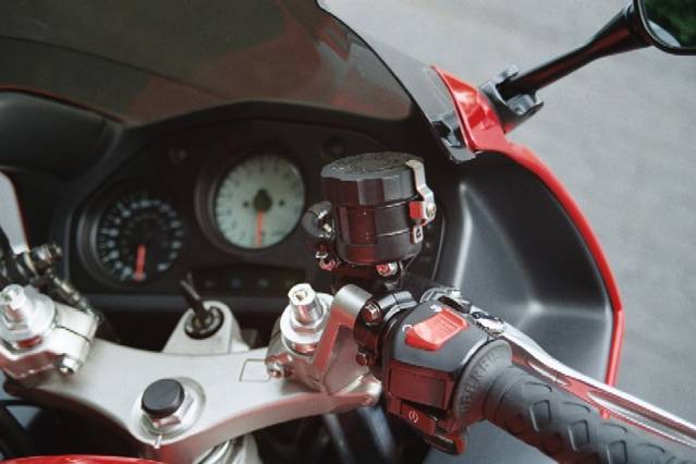

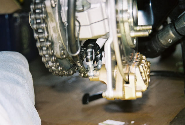

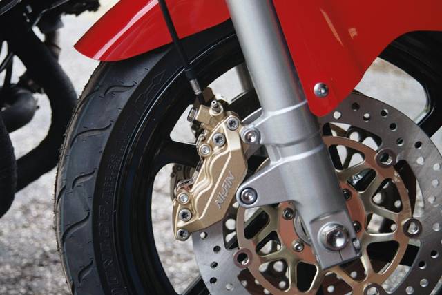

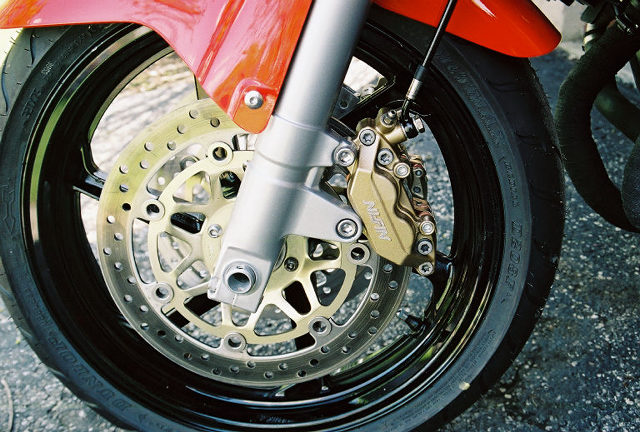

    More pictures. Don't mind all the dirt. Bike was recently stripped and cleaned properly so now is very clean and shinny :)

    Just comments opinion and fodder.. My geekness just jumping out. Never been a fan of that Hel kit. It disables the system, true, but you leave 4 pounds of unsprung hardware hanging in the breeze doing nothing hanging on the forks. And its still more complicated than needed where it could be simple. Thats a whole lotta work and cost for something that is still a compromise. You end up with a system that the master cylinders are not not proper sized, especially the rear.....
    Really for near the cost of the HEL kit, the Superhawk lowers/RC51 calipers and master cylinder could be done...

    Very nice work. I know I have some dead weight hanging down, but my brakes did improve and I can use them independently. I was thinking of upgrading front calipers however I would have to change the forks...And I was just thinking of upgrading for hagon springs, in the end of the day I will have to take forks out so maybe I will think of upgrading them to a vtr forks or something. Thanks for your picture and opinion.
