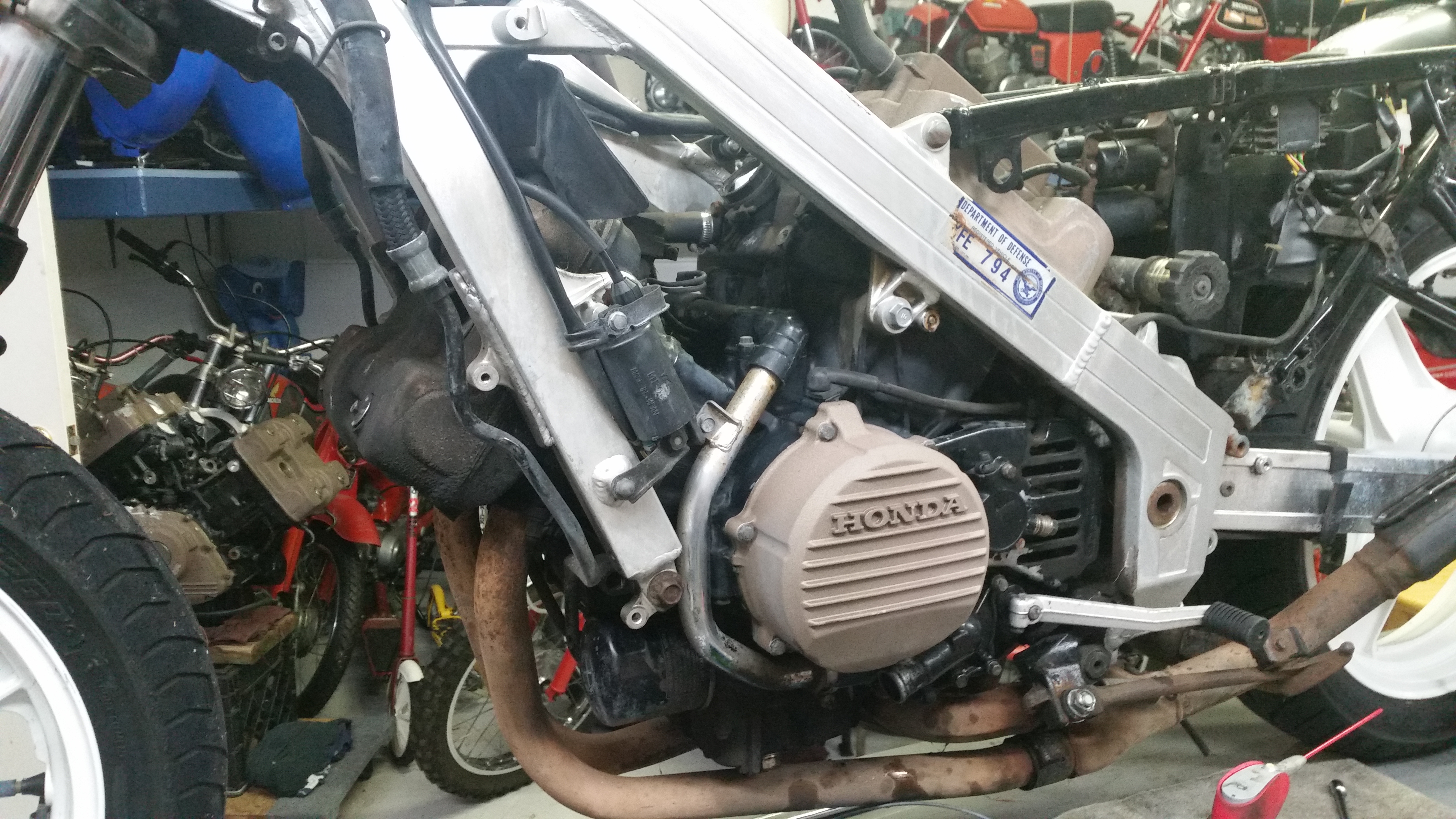

    OK... let's do another one. It is starting life from this bike.
    38K miles. Sat outside for about 7 years without a cover... in Seattle!! Ugh.
    Most everything that isn't essential to starting it has been removed. Pretty much threw the whole brake systems, front and rear, in the trash. Saved the front calipers just to see if the pistons want to come out and what they look like. Rotors were junk. Oil is clean, coolant just looked old.

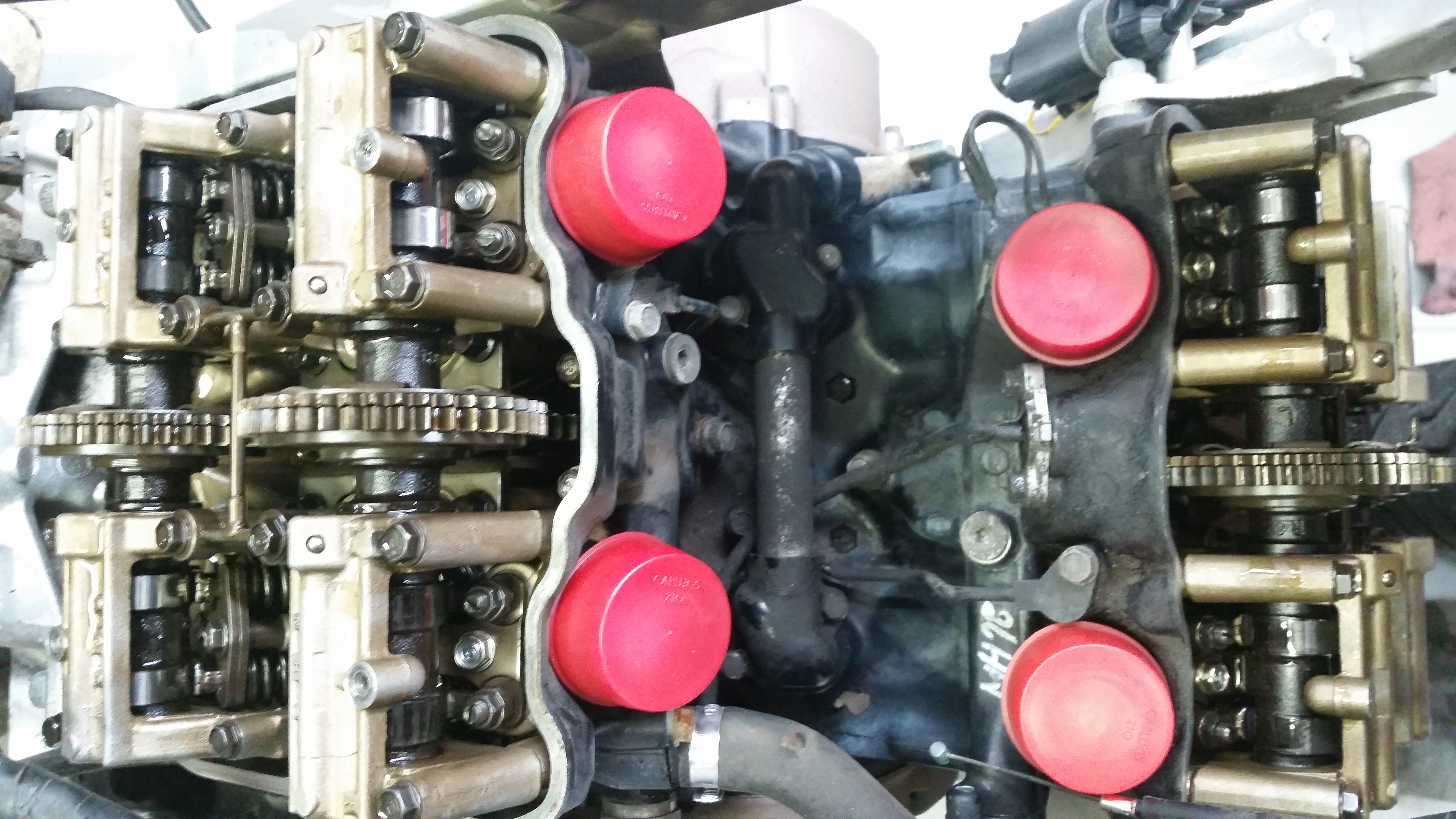

    Next is to pull the carbs and completely rebuild them. I am also going to pull the valve covers for cam inspection. I don't suspect any problems, previous owner seemed pretty competent until he flaked out and parked it. I will pour some oil on the cams and squirt a little down the plug holes before turning over by hand. The carbs will go back in to run it before the bike gets disassembled.

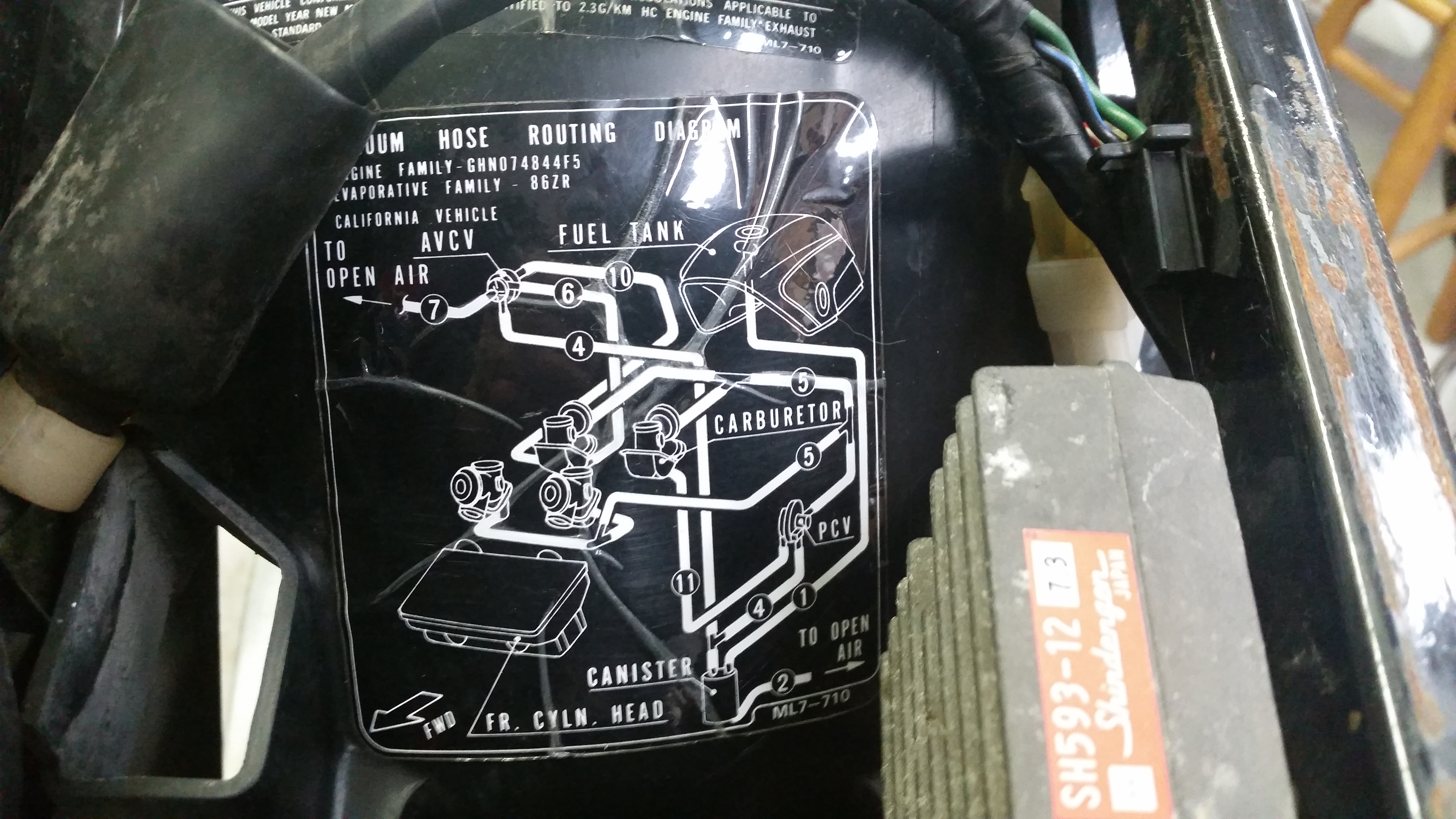

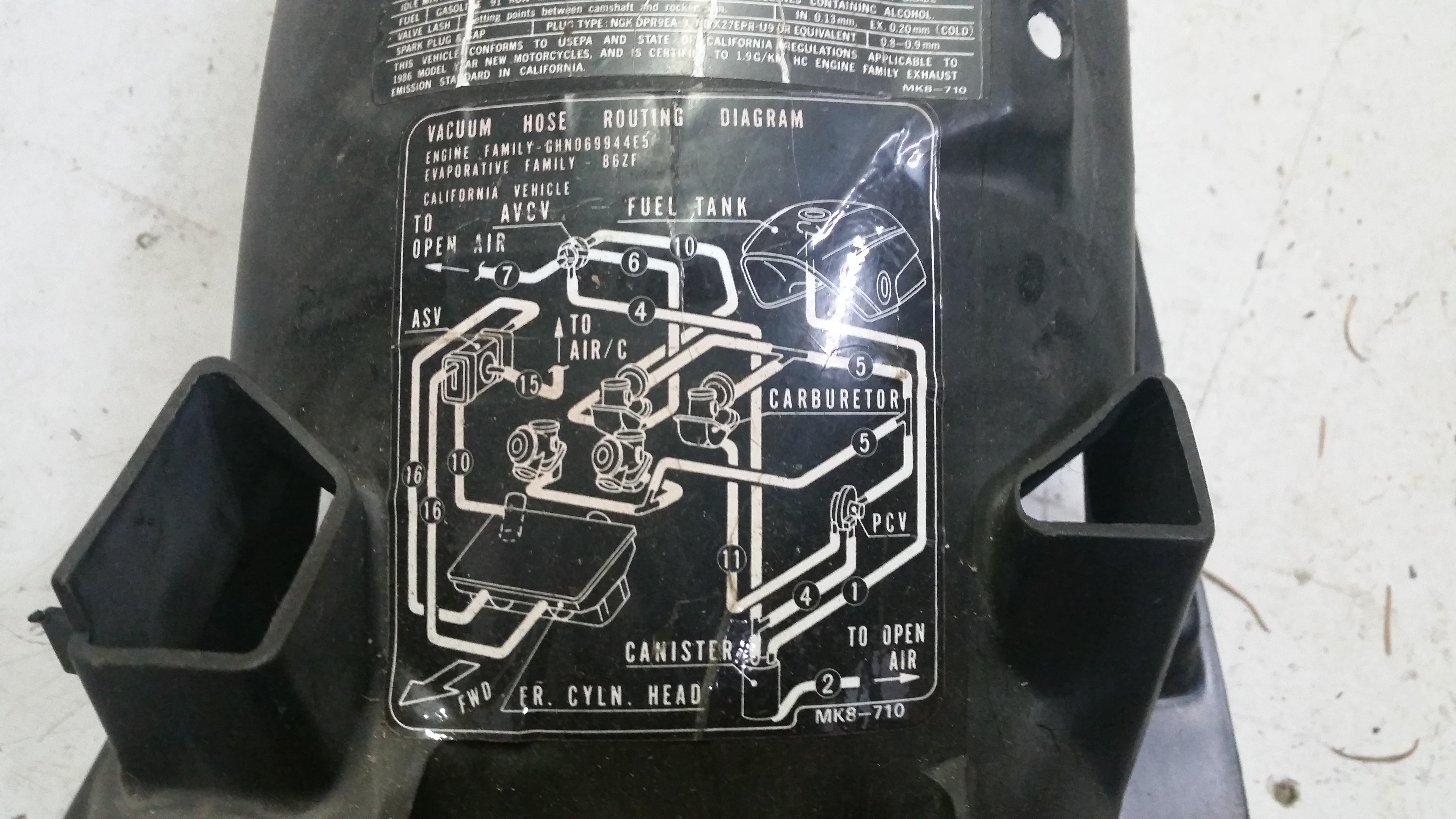

    It is (was) a California bike. At first I thought the engine had been replaced at some point. It doesn't have the ports in the front head and doesn't have the "pump" on the right next to the coil. But after looking at the vacuum hose routing sticker on the inner fender, apparently 750's didn't get them. But if you look at a sticker on a 700, it shows them. I never knew that!

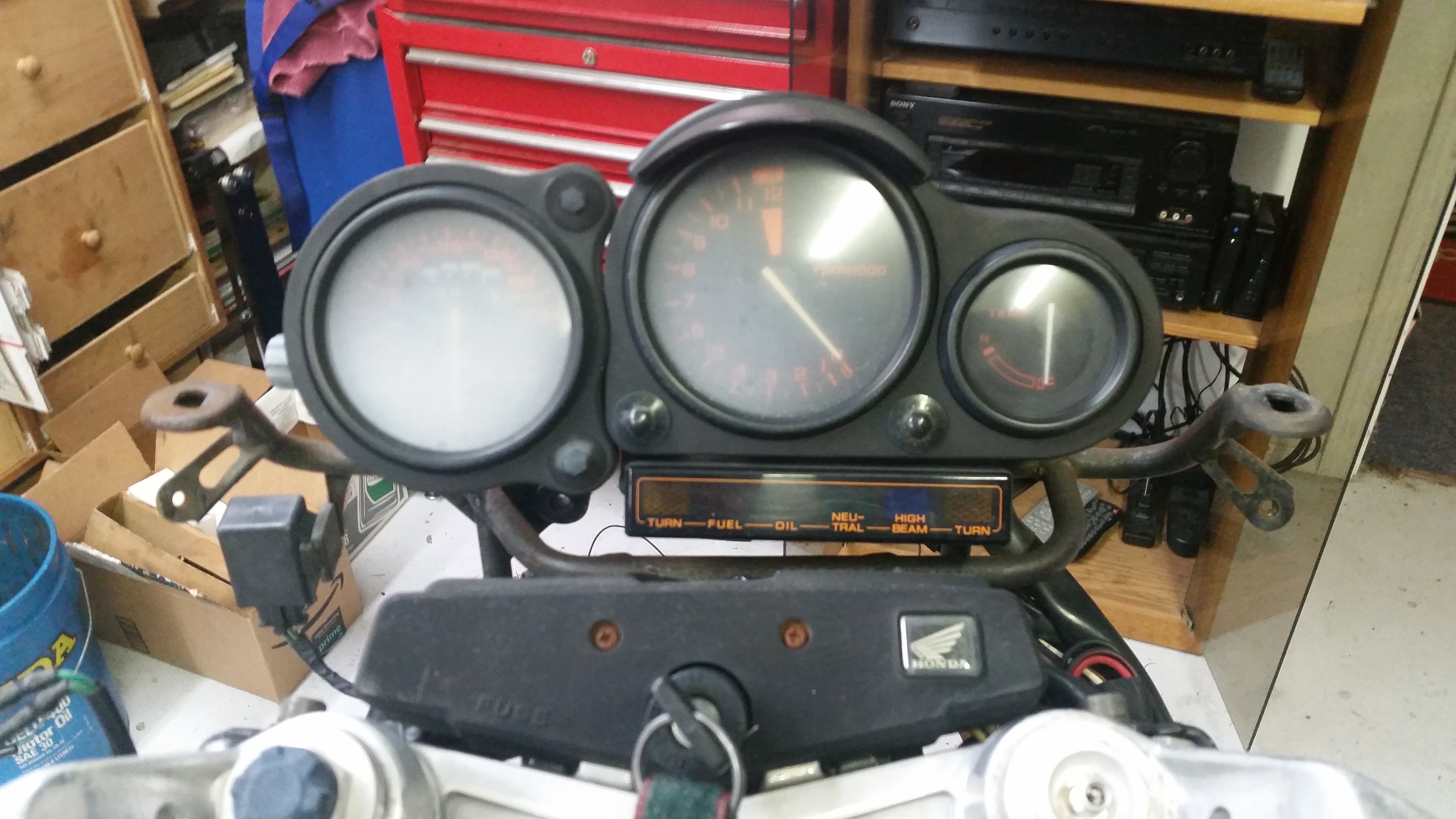

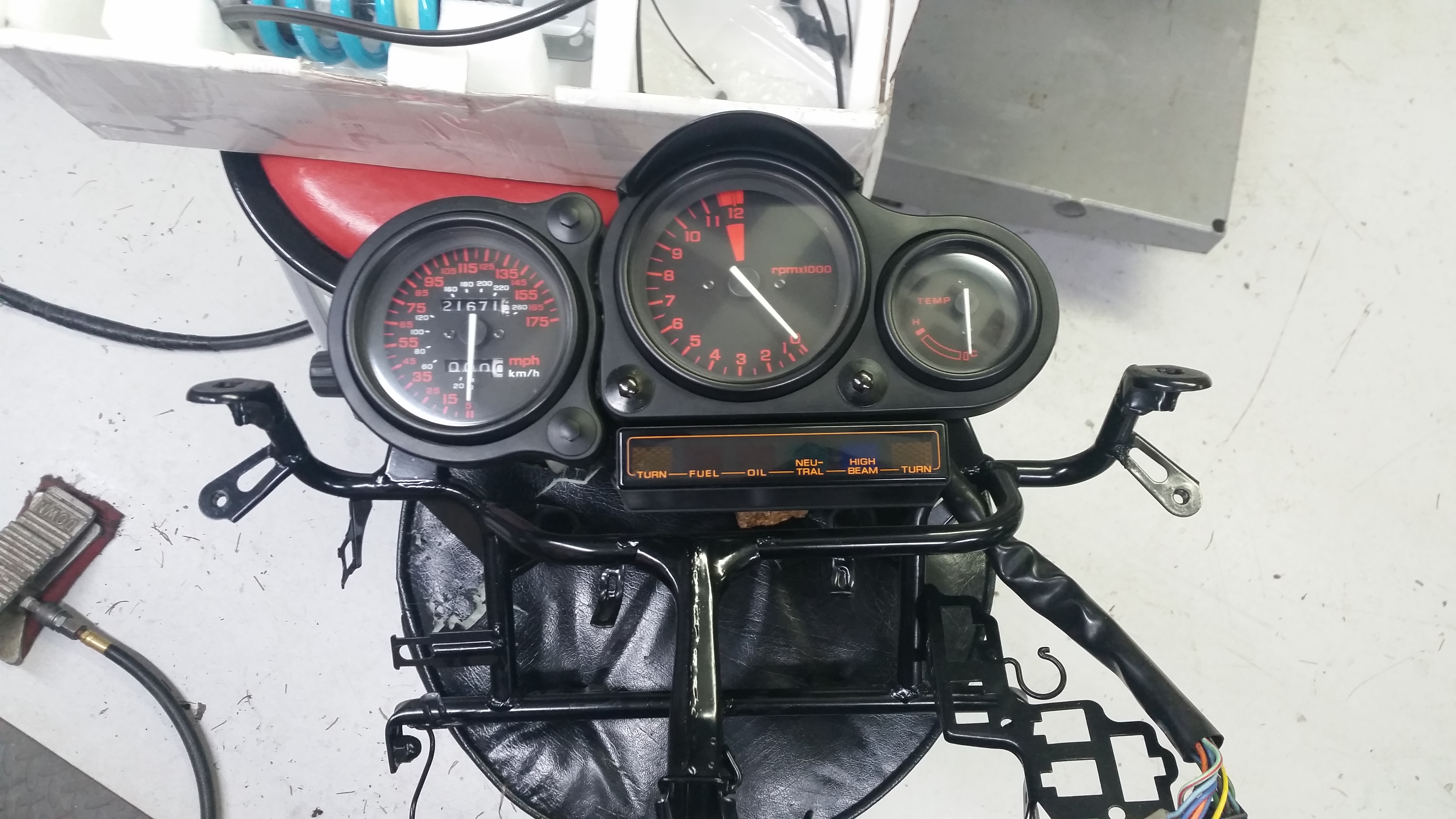

    Gauges are pretty toasty.
    But I have these already done and waiting to bolt on.

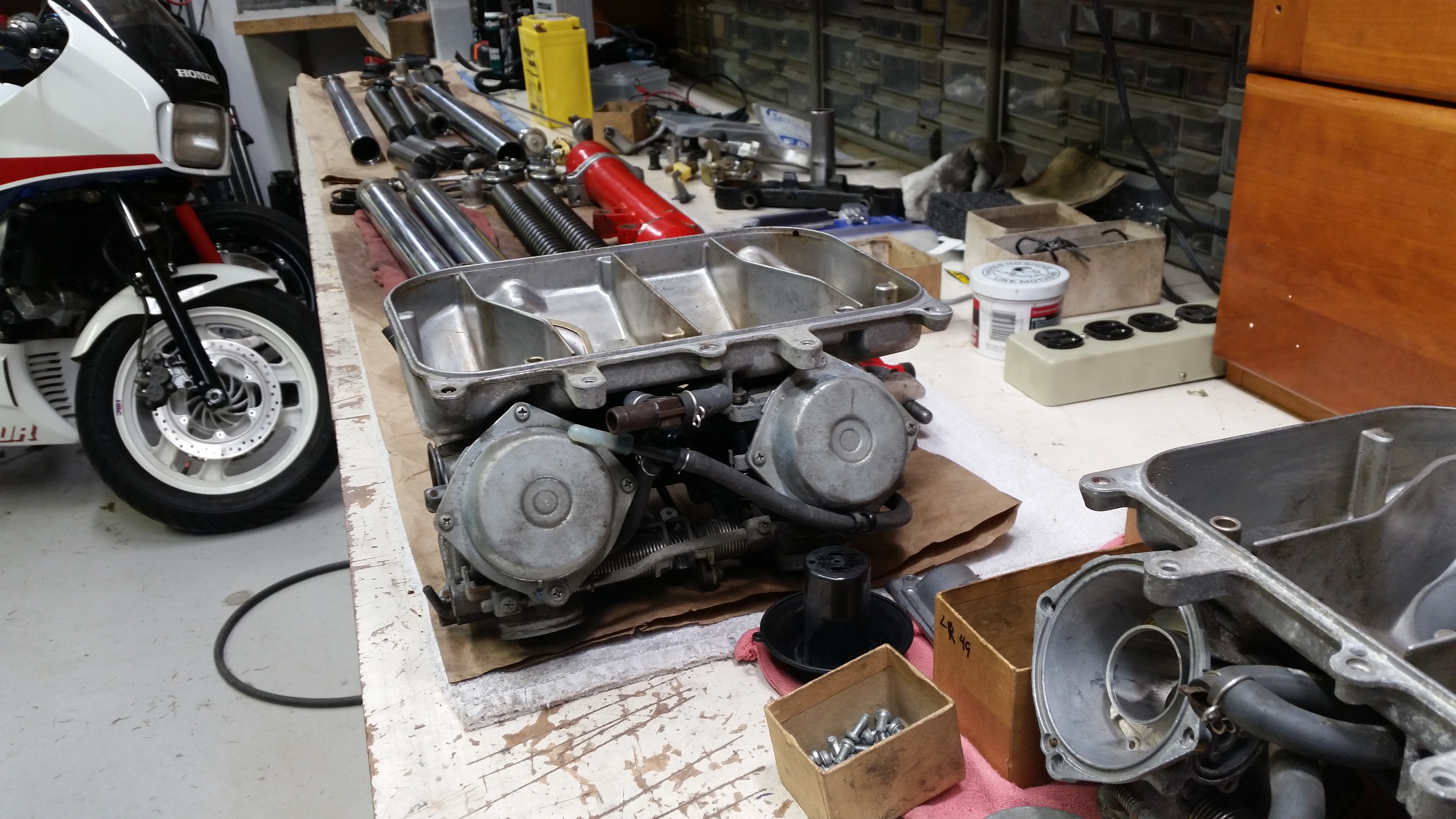

    Carbs out, Radiator removed. Time for another bath before pulling the valve covers.

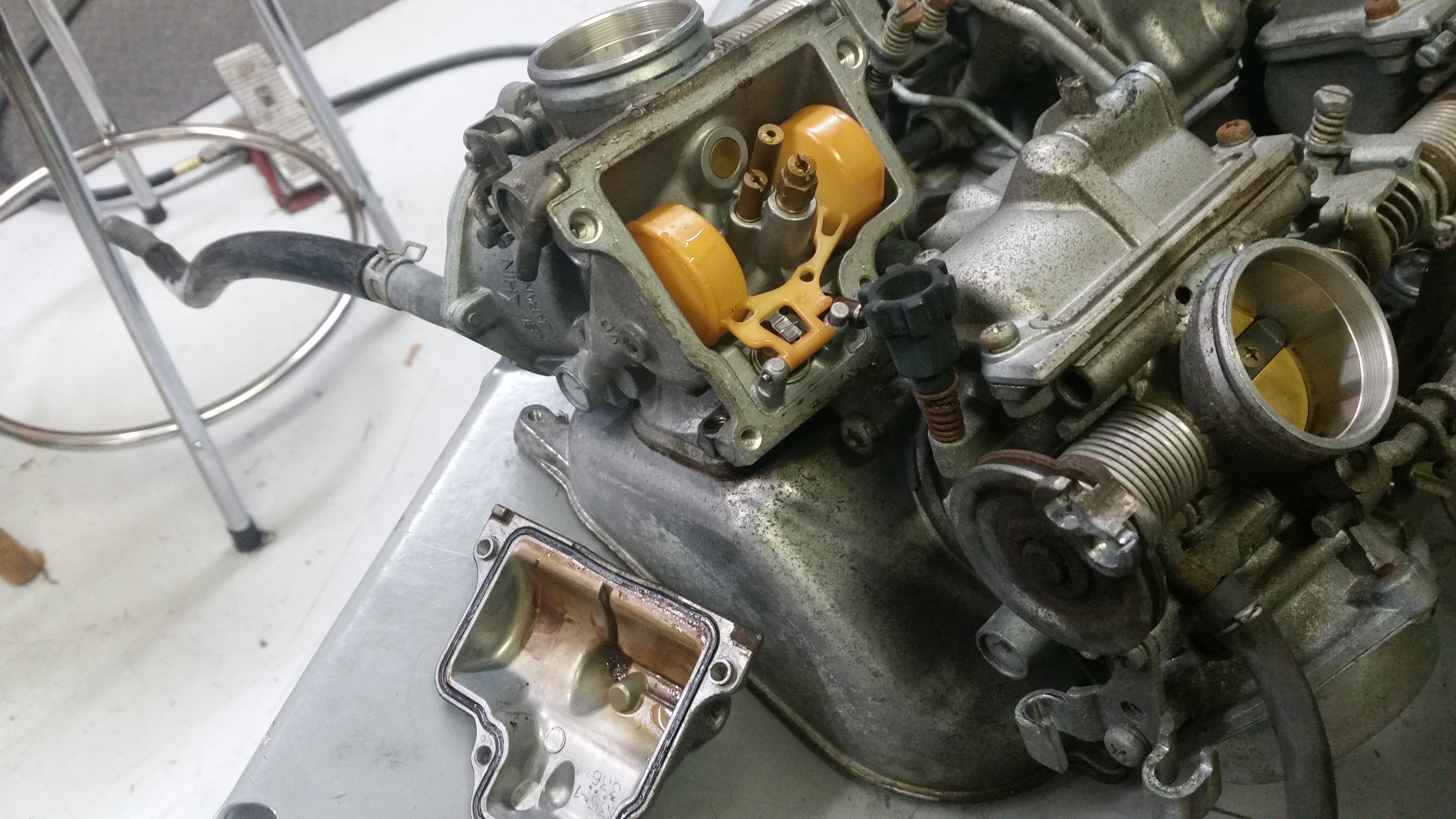

    I was going to wait until the next day to take the carbs outside for what I was expecting to be very nasty, but I decided to pop the left rear bowl off for a quick glance hoping for the best...
    Very pleased! They didn't even smell bad. This will be an easy rebuild looks like, they had good action before pulling and the starter valves all moved nicely. I don't think they have ever been into, the throttle cables still had the yellow markings on the nuts and none of the float bowl screws were rounded. Hoping to have them done this weekend, maybe one morning with coffee.

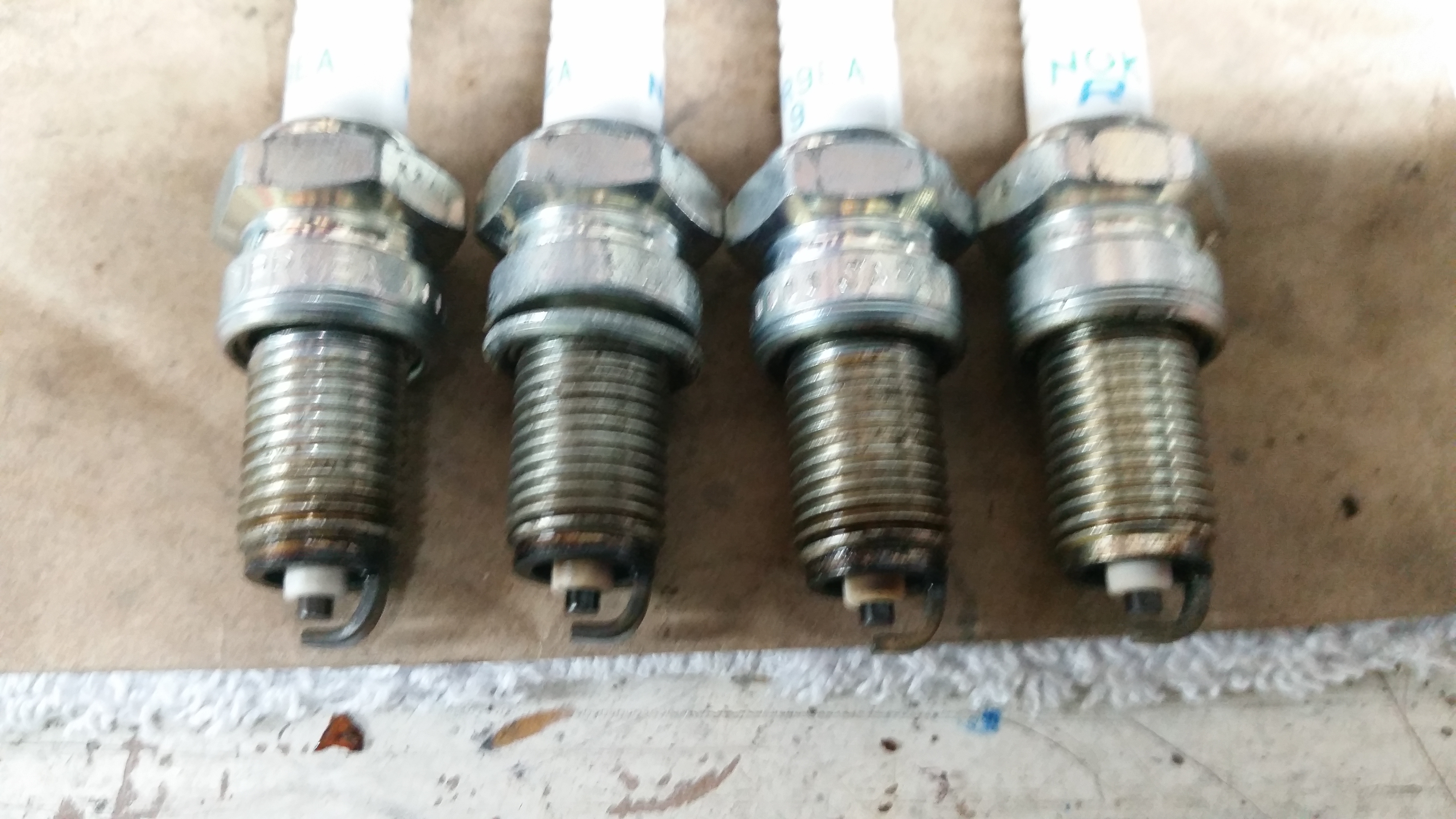

    As suspected, everything looks perfect. Not a scratch, line, pit to be found anywhere. Turned over by hand easily with no weird resistance or noises.
    Running a little lean when parked, which makes sense. He said it started running rough. Local independent service shop scared him with a ridiculous doomsday estimate and it got parked. Good for me, I suspected dirty carbs immediately.

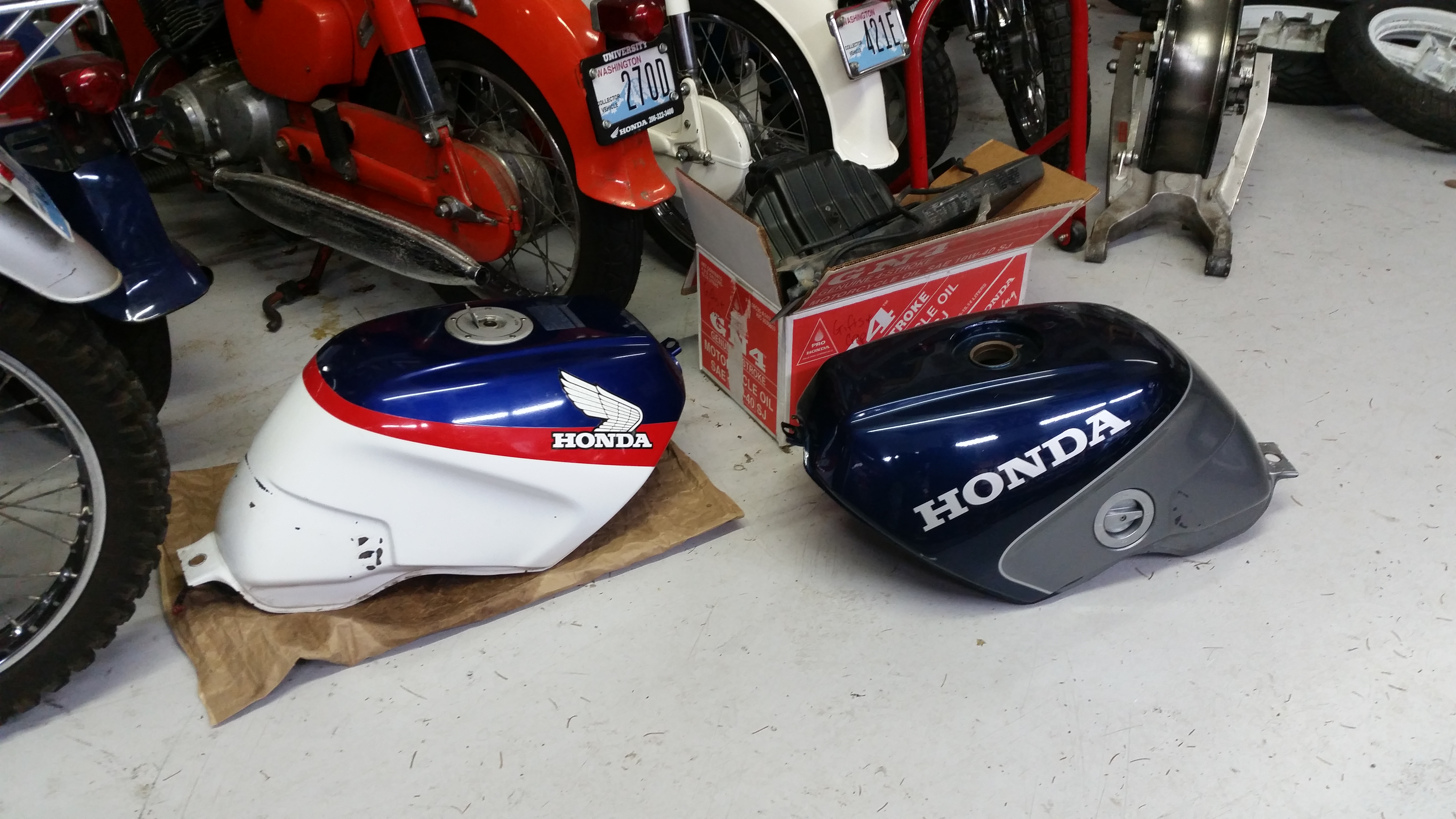

    The original left cowl and upper cowl on the left are fairly bad. The rear cowl around the taillight doesn't have any cracks and the solo cover is saveable. The right lower cowl is nearly perfect. The tank is pretty nice with very minimal rust but the decals are super faded. But I have another complete set of bodywork that I have been collecting that will get some paint. Thinking about a play on the 87 blue.

    i think the blue is a pretty good idea - the dark blue is excellent..

    I have always thought, if I was going to do a late 80's, I would go for this scheme. Minus the yellow number plates and the non HRC sponsor decals.

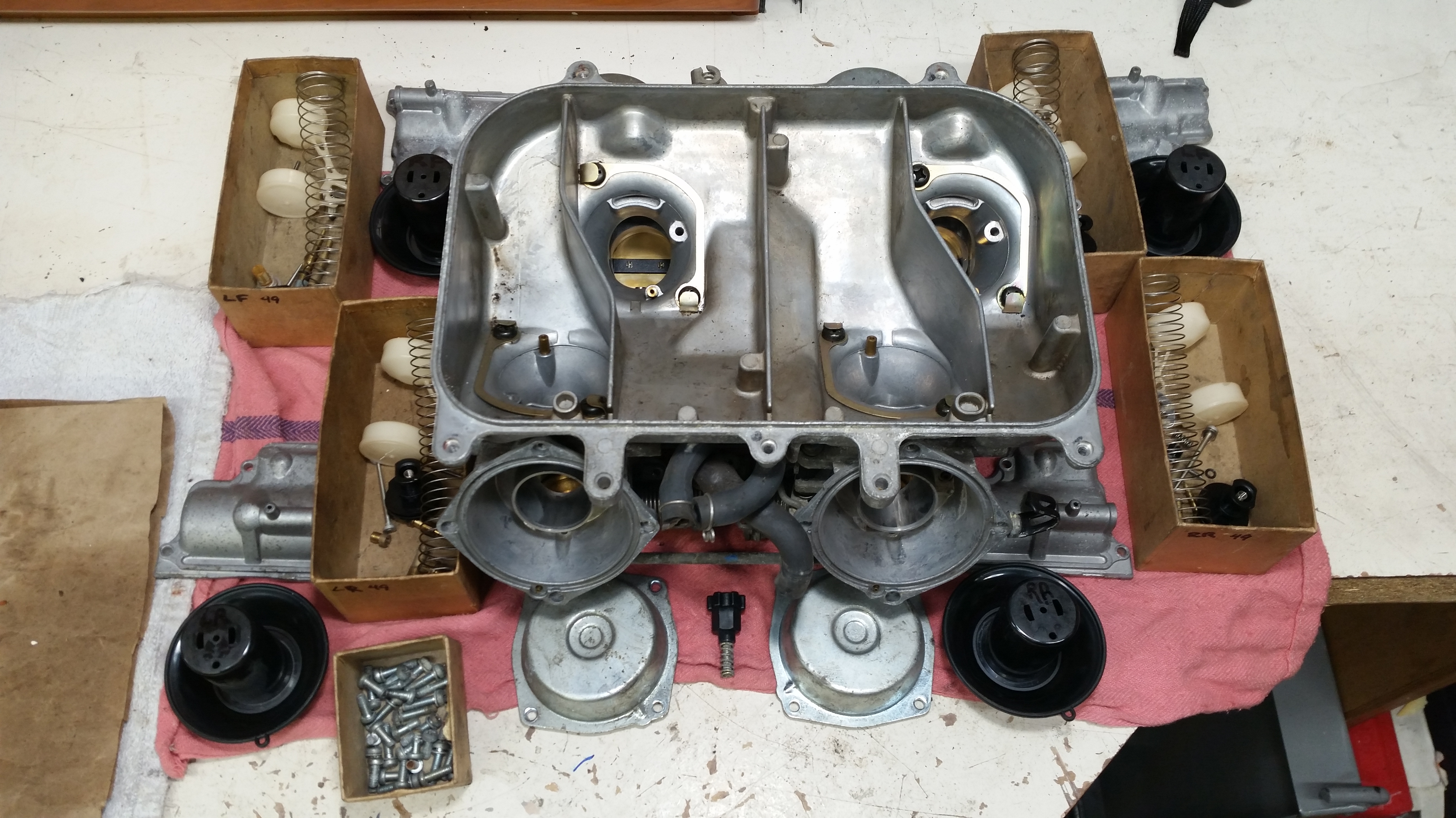

    Decided to disassemble some 49 State carbs that I got , ironically, off of a Cal parts bike I bought years ago. They look pretty good. Stock jetting and somebody shimmed the needles 0.5mm. Oh, and they also pretty much mangled all of the float bowl screws.
    Gonna go thru the Cal carbs too and see whats there.

    What're those red covers you're using to keep the engine safe while the carbs are out? Excellent work as always.
    7,616
    3,700
    They're Caplugs. I work at an Aerospace Manufacturer and we use them (all sorts of sizes) to cap parts (tubes, ducts, lines, etc) after they have been cleaned in the vapor tank.
    It was a couple days before I was gonna roll the bike out for a bath and I saw those at work. Took a couple sizes home and these were perfect. I've been taking smaller sizes home for a while, but I finally thought of this. Usually it's a small rag remnant with plastic zip tied over.
