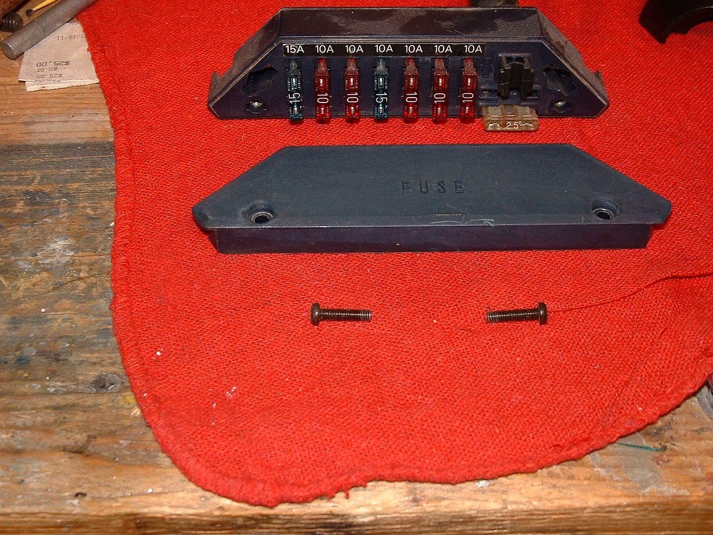

  5. Railguy
    Railguy New Member
    Mar 2, 2010
    57
    New Mexico
    this is a 87 F2 block

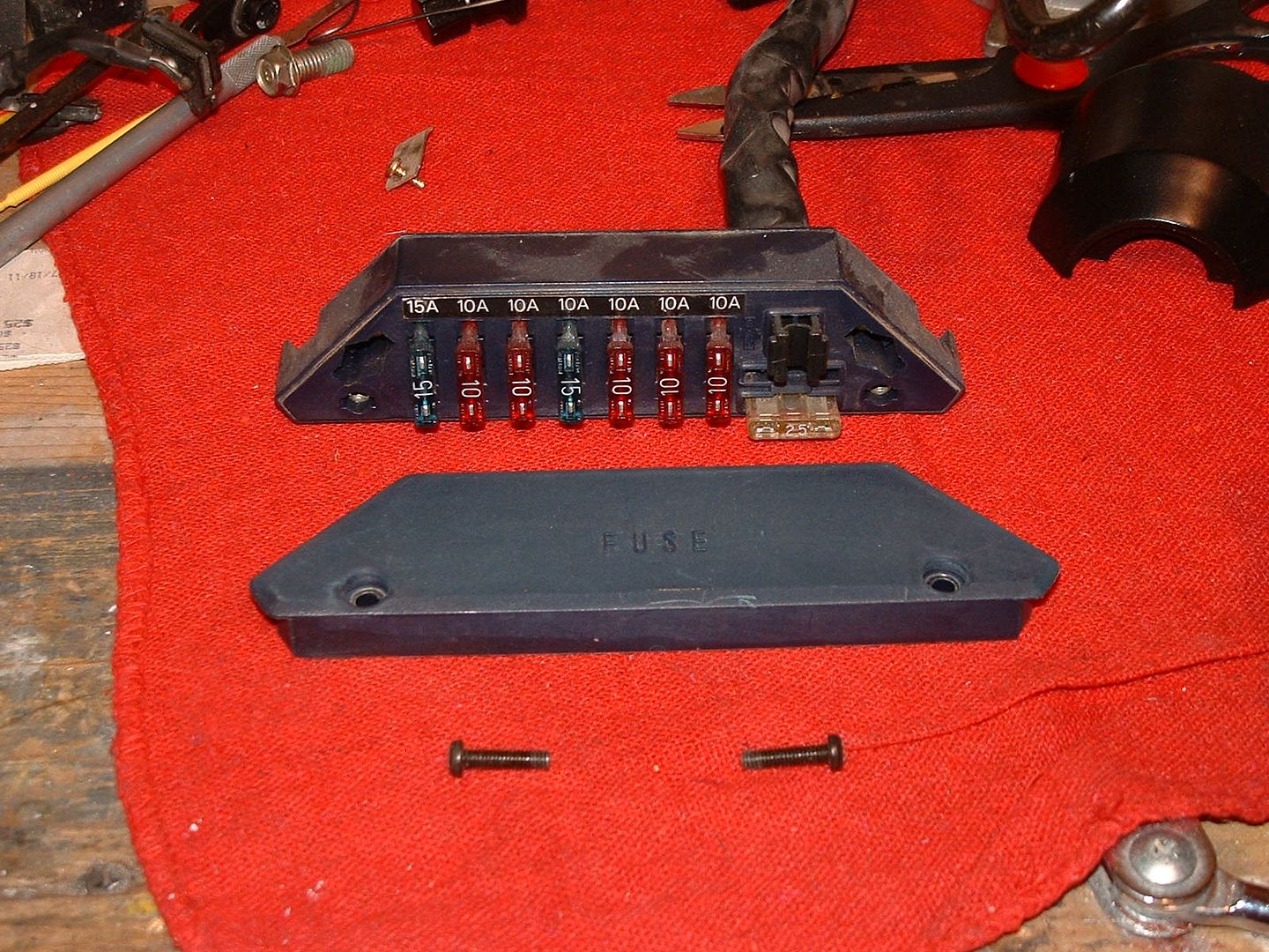

  6. 82ndGreasemonkey
    82ndGreasemonkey New Member
    Jul 6, 2011
    335
    S. GA
    TC- what do you mean yours is "under" the cluster?
    Here's what I got:

  8. summitlt
    summitlt New Member
    Jul 8, 2010
    The two holes in the fuse block itself used to have two small nuts inside. Held in with two small clips. the fuse cover should have two plastic screws. If you push more than turn its easy to pop the nuts out.

  11. stoshmonster
    stoshmonster New Member
    Jan 1, 2009
    1,436
    The Frozen Wastelands of Wisconsin
    Dunno if this will be of any help Greasemonkey but according to the Honda Parts fiche info that I've got it just calls out those fuse cover screws as being two standard 4mm x 20mm phillips head pan screws just like this but without the lock washer and flat washer,same as Rail posted earlier.
