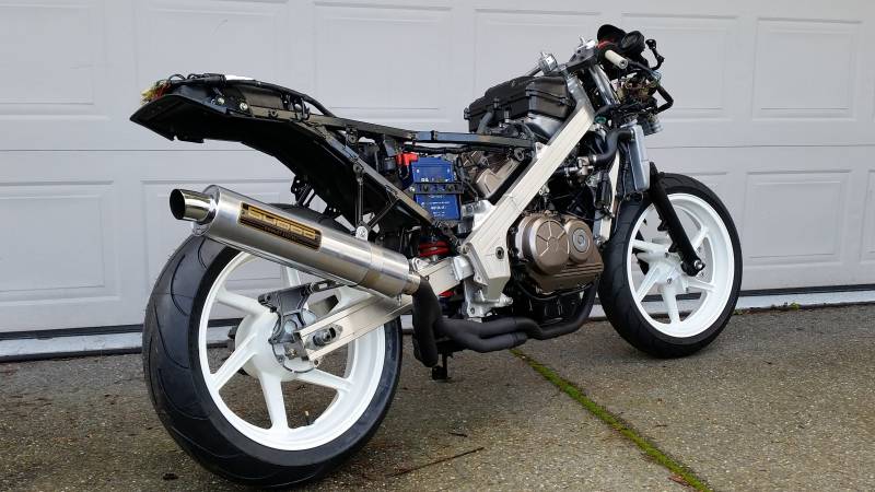

    The Tyga I put on the RC26 is beautiful looking and sounding. And was reasonable.
    Mount it where you want it and have a connecting pipe made. The header system you have is good.

    Dude, I just looked at Tyga yesterday and was wondering if anyone had one mounted. I really wanted to to go with that so, F yah!! Get that bad boy on order this weekend maybe. I really like that company. Solid customer service and great parts so far. Although I was thinking of a carbon, but that is $320 or so.

    Shitty pic

    Nice bike makes up for the pic. That exhaust has now inspired me. Thanks dude. 380mm or 450mm? Looks like 450.

    450. I test rode the bike with a 380mm D&D can and it was a bit too gnarly on this exhaust. I know they are not the same can, but it was the first time people were snapping their head around when I was approaching. The 450 just sounds sweet, but still plenty racy. I really wanted to run the shorter can for aesthetics, but didn't want to live with it.
