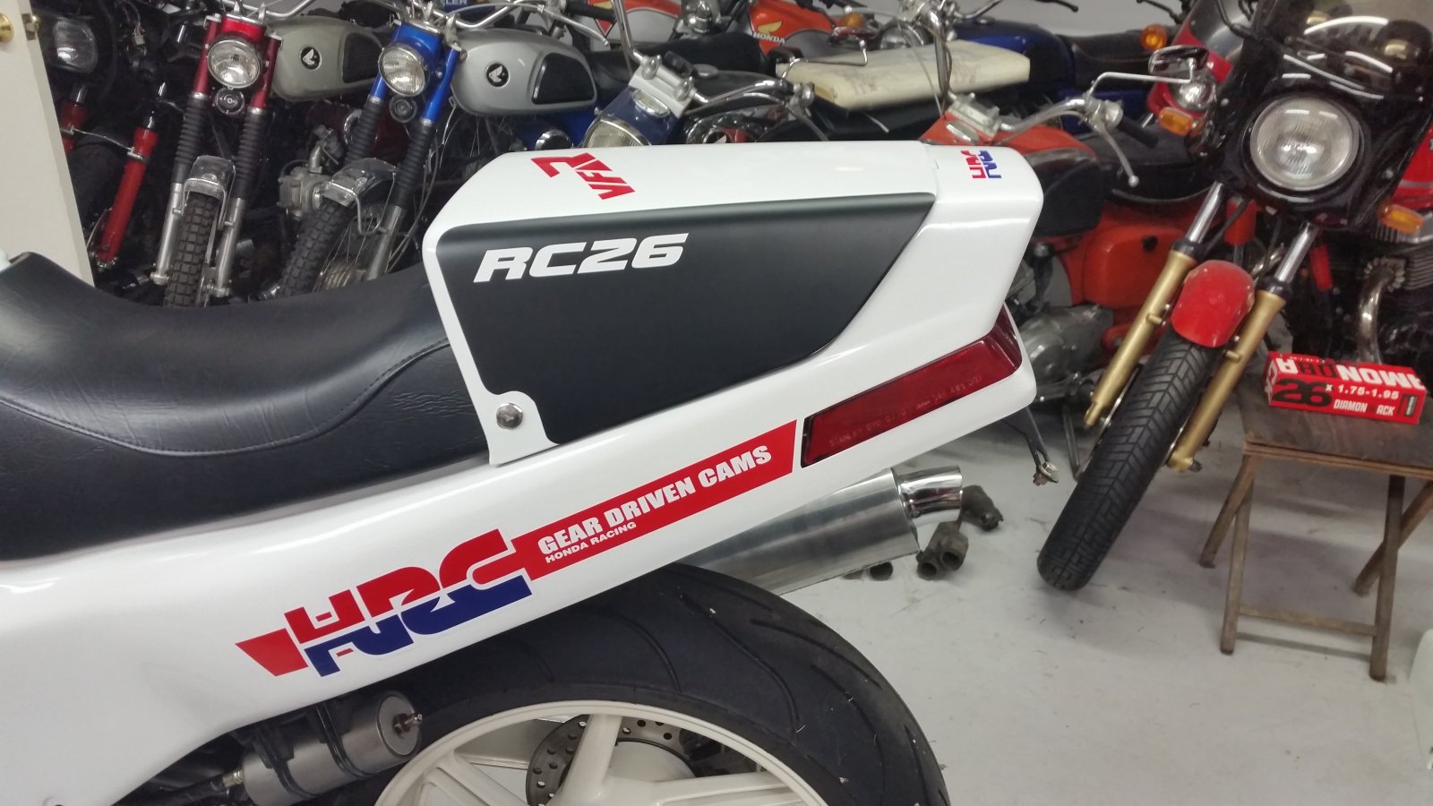

    son of a... I can't handle cliffhangers. I gotta know what that fairing is. proper english right thar
    7,494
    3,567
    Cmon.... you already know...
    CBR900RR
    Hence the "RC26".
    Only way I was gonna have an "RC" with the sweet dual round headlights.

    So jelly. I want round headlights. :( Is there a writeup on that vfr? I love the wheels. F2? And yes I had a strong feeling 900rr. I had a buddy with a sparkling new one when they came out. I had my junker hurricane that lasted forever. :)
