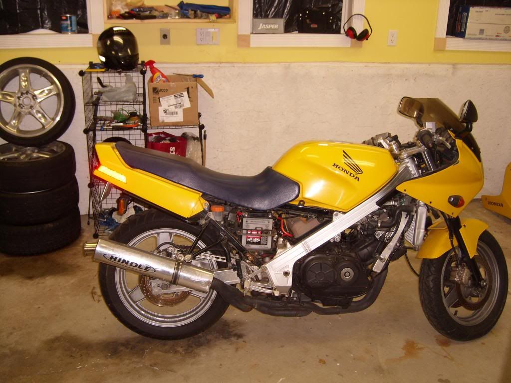

    I'm planning on sending the carbs out to Billy C to be rebuilt and I'm trying to figure out before hand if I require a re-jetting. The carbs have not been touched in my 5 years of ownership.
    It's an 86 VFR750F that originally came with a oem paper air filter and a dual exhaust. These have been swapped out for a K&N and a 4-2-1 system with a straight through exhaust.
    As you can see in this picture, it's a pretty free flowing exhaust: http://i346.photobucket.com/albums/p435/Amos830_photos/SL733906_zps777aaf17.jpg
    Some of the symptoms that make me question if they need re-jetting is an exhaust popping on deceleration and quick throttle releases while coasting and letting the engine brake. She still pulls hard; granted I don't know anything else.
    I just need to let Billy C know what route to take and figured maybe someone here has a similar equipped bike and has some experience with the pro's and con's of re-jetting.
