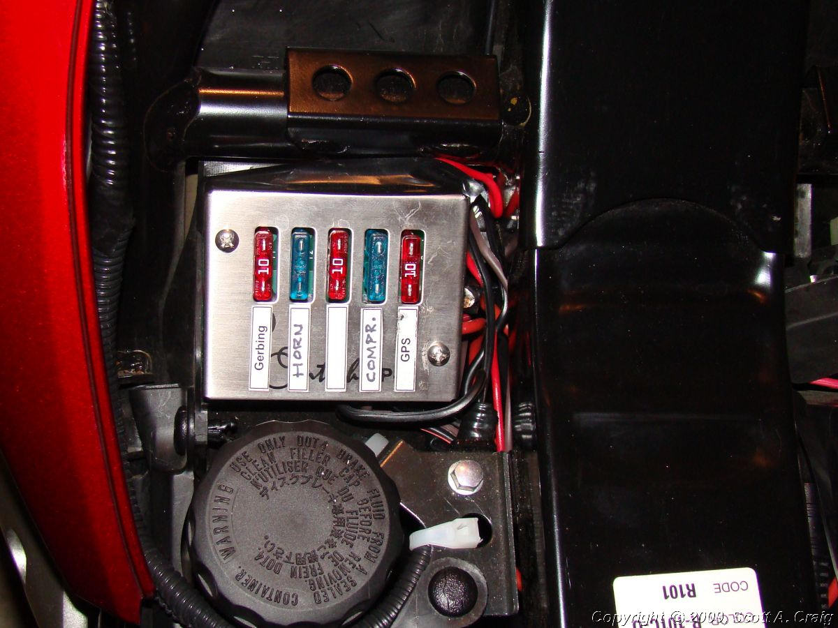

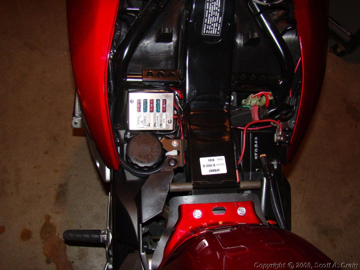

    I've got one but never could find a place to mount it. Perhaps it would be more appropriate to say I couldn't find a place to mount it where I could get to it if a fuse cooked on the road. Meaning I didn't want to put it behind the fairing or anything, I wanted it where I could easily get to the fuses. I did get a Centech fuse block to work though. It fits fine right behind the rear brake fluid reservoir under the seat.
    Images are links to larger photos. Click the image below to view the larger photo.

    Thanks for the pics Scott.
    My friend already ordered the Blue sea box so we'll have to see if we can
    fit it under the seat somehow.

    You're welcome, but I don't think you'll find room under there. The 6 gens just don't have much room at all under the seat. I've got a brand new Blue Seas box at home and just plain couldn't find a place I liked to mount it.
    Good luck with it, and if you do find a good spot I'd love to know where it is just out of curiosity.
